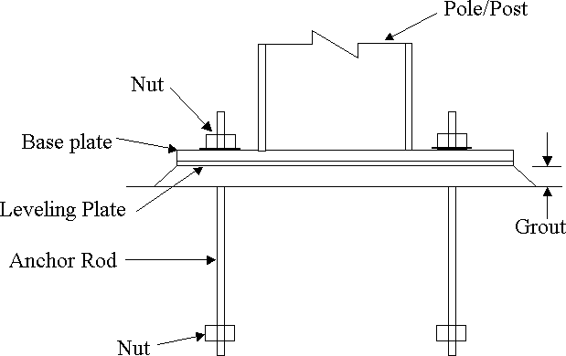

Does anyone have a feel for the flatness of Portland Cement when poured in a standard/typical way? Say, for example, that I wanted to pour a cement "cube" (20"x 18"x 19.25") in a mold. How flat would the top surface be without any special procedures?
Background: I am going to mount a forceplate on top of this cement block and I am trying to determine if I need to specify the flatness tolerance in the drawing.
Is there somewhere I can look for this information?

  • $\begingroup$ The word forceplate completely new to me. Is it the same as a baseplate/endplate/faceplate? Bolting a steel baseplate to a concrete base is common. In this case the normal procedure is to cast the concrete base with anchor sockets in it. Once the concrete is cured, the baseplate is bolted in with a wet mortar bed between the plate and the concrete. This ensures a completely smooth contact surface. See fhwa.dot.gov/bridge/images/sign12.gif. (I know this doesn't actually answer the question you asked, but I hope it may be useful.) $\endgroup$

If you live in a country that uses ACI standards, you might consider specifying flatness using an FL or FF number. ACI 117, Commentary Table R4.8.4 has this information, with flatness ranging from "Conventional" to "Super Flat." For the dimensions you have listed, specifying anything beyond "Flat" is probably overkill since your forceplate will likely cause the underlaying slightly-unflat cement to consolidate to the face of the plate anyway.
However, what I said above may be overkill for what you're doing. I'd just tell them to overfill and then strake it off using the top of the form as a guide, just like what you'd do scooping flour for a cookie recipe. That should get you what you want.

    $\begingroup$ @Wasabi is right - if you just dump something in one spot, it will take the shape of a cone. The slope of the cone is known as the angle of repose (the link he gives is a useful read). With a 15 degree angle, you still should trowel the cement to form a trowel finish, which is usually defined as no more than 1/4" standoffs between high and low spots when measured w/ a 10' straight edge. $\endgroup$

  • $\begingroup$ @Mark just to be clear, a trowel finish is flat within +-0.25" across a 10' distance? that's the kind of spec I'm looking for. Did I understand that correctly? $\endgroup$ Jul 8, 2015 at 17:03
  • 1
    $\begingroup$ That's correct. The specification is ACI 301-72, Secion 11.7.3. $\endgroup$
